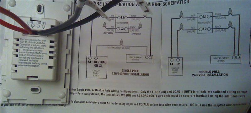

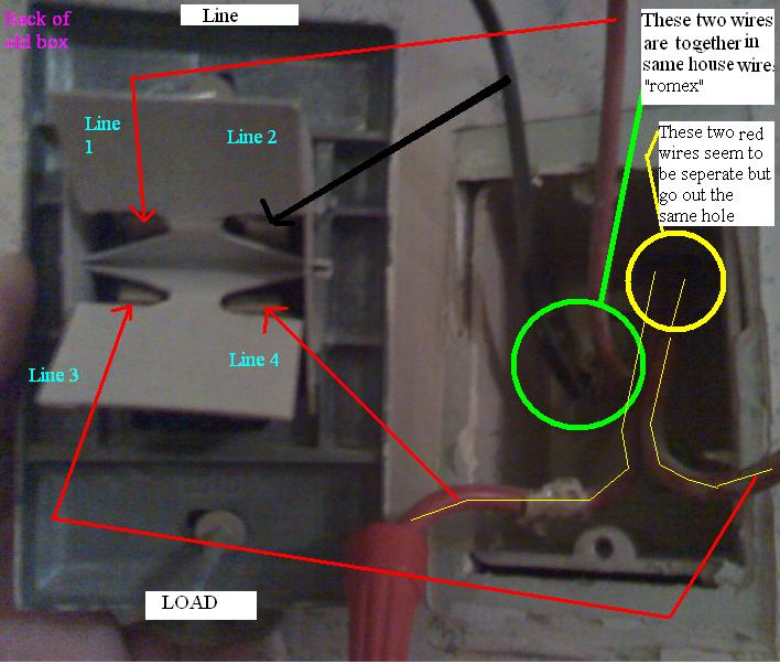

Today my new thermostats arrived and I took the old thermostat out and saw that I had 4 wires. I opened the new thermostat and it had 4 wires as well. When I looked to start matching up wires and or numbers I noticed I had a black and a red and two red. (HMMMMMM) I looked at the instructions and they say I should have a red and black and a red and black.
Does anyone that knows electric better than me have any clue on this one? I am good with normal wiring but when there is a curveball like this it REALLY throws me off. If this is something simple that you can just tell me something like. "Oh I see what is going on... You just need to connect the old 1 to the new L1 red and then old 2 to the new L2 red. and then the old L3 to the new L1 black and the old L4 to the new L2 black." or something like that then I'll give it a try...

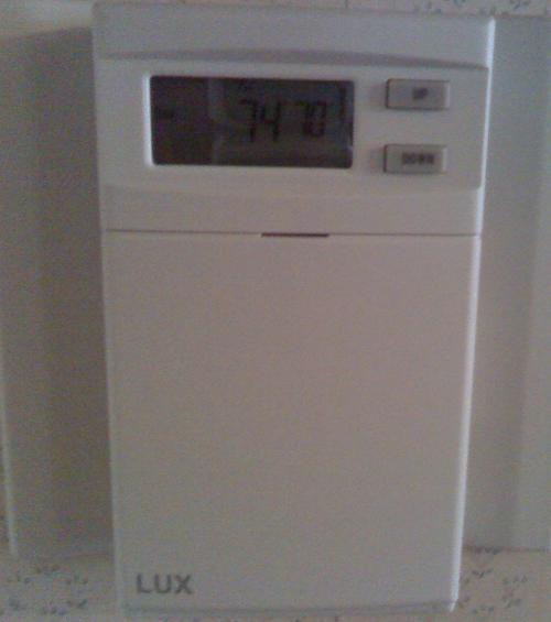

With matching assumptions from Waterboy on Facebook and a co-worker in Facility Engineering who took a look at this thread I got it wired up and working...
Makes me want to do the rest of them as some rooms REALLY don't need to be kept near as warm all week as others. Some could drop off during the day when no one is home and would only need to kick on for a few hours a night.
(if the wood heat was not doing its job at the moment) Right now none are kicked on and the house is 72.3 lol That room in particular was 74 #:-s .
Works, red and black to red and red on unit then red and red to black and black on unit.JPG
Works, red and black to red and red on unit then red and red to black and black on unit.JPG (21.08 KiB) Viewed 2262 times
