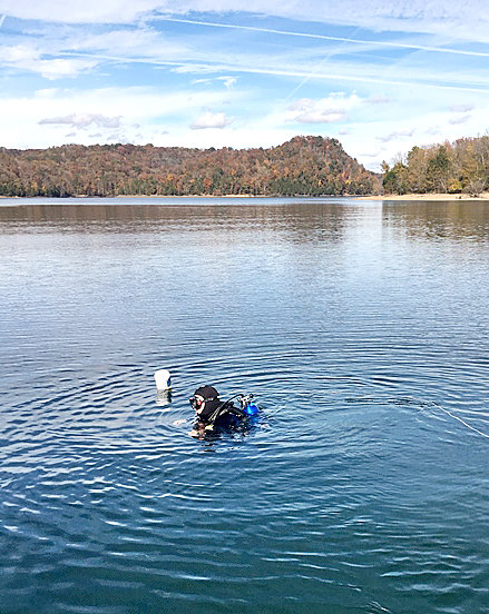

Tony Waters prepares to dive next to the buoy marking the stone's location.
Dale Hollow 1.jpg (111.6 KiB) Viewed 13030 times

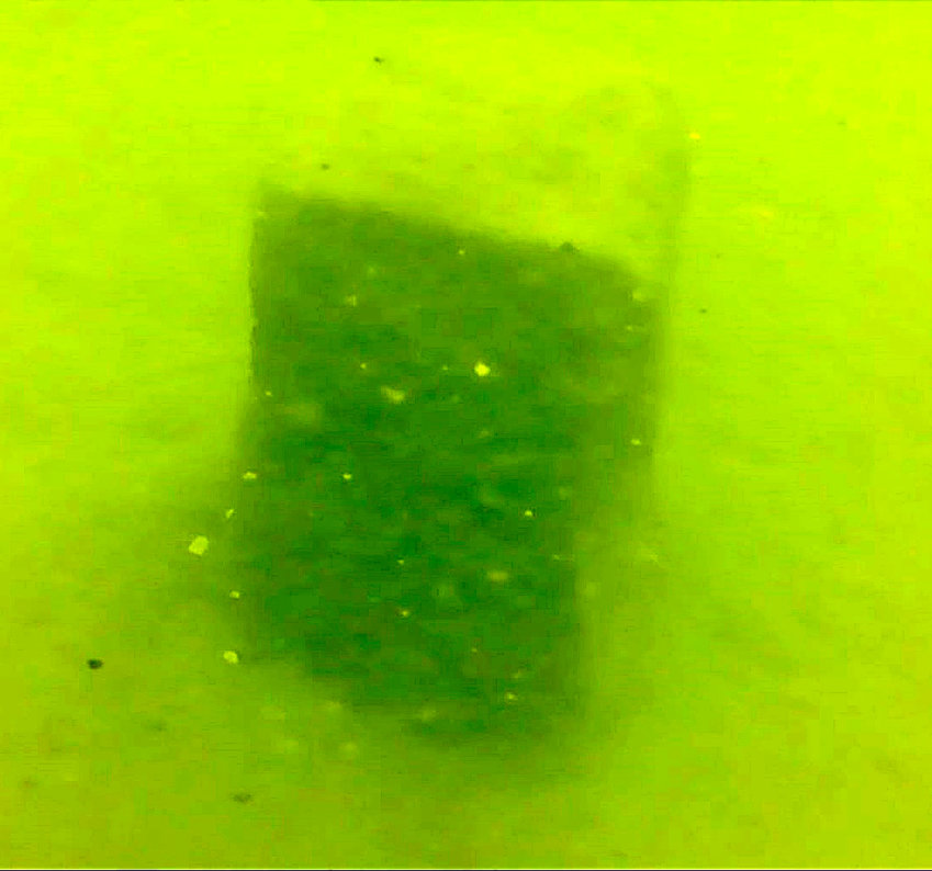

Stone #46 sits at the bottom of Dale Hollow Lake.
Dale Hollow 2.jpg (107.75 KiB) Viewed 13030 times

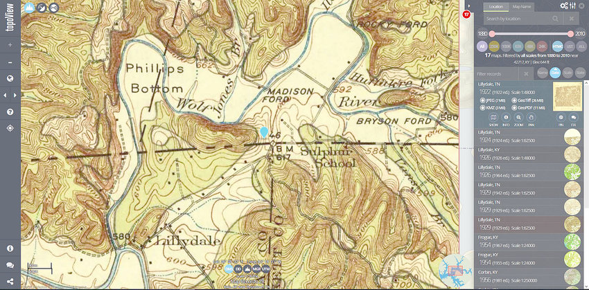

The 1929 quad map was the last quad map to mark the stone's location.
Dale Hollow 3.jpg (189.63 KiB) Viewed 13030 times

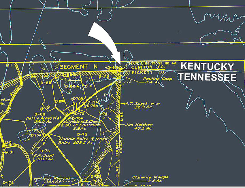

Charles Whittenburg used the 1942 United States Army Corps of Engineers map to verify the stone's location.
Dale Hollow 4.jpg (250.31 KiB) Viewed 13030 times

The original U.S. Army Corps of Engineers maps for the land acquisition of Dale Hollow Lake, which was created in 1943, clearly labeled stone #46 next to a popular trail.
Prior to 1990, surveyors could only use quad maps, which mapped elevations like mountain peaks and rivers, and there was no map archives easily accessible. In 1929, the quad map showed the stones' labels, but in 1959, the map revision removed them.
"Now we have the ability to pull up a map with stones and match it to a proximity of where a stone should be," Whittenburg said while clicking through multiple years of maps on an internet archive.
Digitizing the maps and orienting them to the two stones he found based on the marked terrain, Whittenburg was certain the missing monument was almost 30 feet underwater at what is known as Cook Pass, which was once a high traffic wagon road.

Tony Waters of the Putnam County Rescue Squad Dive Team used a GoPro to record the dive.
"I was excited to get the opportunity to help and hopefully find it," Waters said.
Within five minutes, he gave a thumbs up.
"I actually came upon this big stump and thought 'well the scan saw this stump and thought it was the stone.' So I swam over to the stump and four feet on the other side of it I saw the marker," Waters said.
The three had to go back to land and use a computer to watch the video.
"Once I played it, then I knew, without a doubt, it was it," Whittenburg said.
Next to the stone, the video showed the hollow stump of a witness tree, which a surveyor would have marked using the cut tree method to reference the stone.
About two feet of the stone shows above the lake's bottom due to erosion. The men plan to return to the site in the spring to clean the stone and photograph the engravings.
