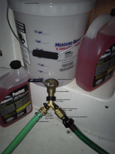

Below are the parts I used and the price at the time. Sure there are other parts that can be used (like how I used a MIP) and you can buy much cheaper parts but this is what I liked when I was in the store and it all worked out wonderfully... I feel I have something that will last me years and with all the parts I purchased, pink stuff bought, and even time figured in it was still cheaper than having someone else to it for me. Last night I used it and it was sofa king easy... I would not even mind taking the boat out for a trip mid winter and having to rewinterize it if need be... (well I might not use the fresh water system but the engine is not a problem with the bucket)
Parts
1 – 5 Gallon Buckett 161932 $4.97
1 – ¾ x ¾ MIP (only use the threaded half of, discard rest) 932242 $4.69
1 – 1” zinc coated washer 15012 $1.18
2 – Rubber Washers 215714 $1.33x2= $2.66
1 – ¼ turn sillcock 248909 Used a 1/4 turn model as it is quicker to open up $10.12
1 – 2 way Brass water shut off 228717 $9.98
1 – Watts ¾ x ¾ garden hose fitting 34756 $6.12
2 - 5/8" & 3/4" Female Metal Clamp Hose Repair 110625 $3.48x2= $6.96
1 - 5/8" & 3/4" Metal Clamp Hose Mender 93124 $3.48
1 – 5/8" & 3/4" Male Metal Clamp Hose Repair 93156 $3.48x2= $6.96
1 – Piece of garden hose around 15’ or buy one $8.00

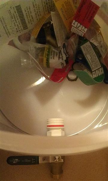

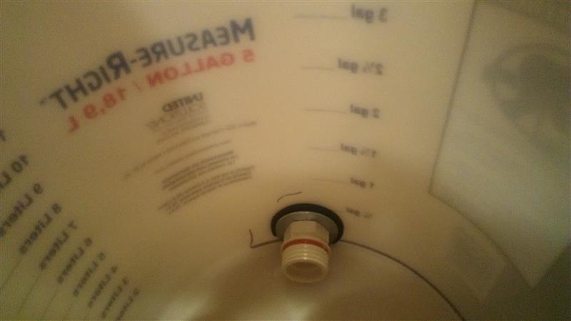

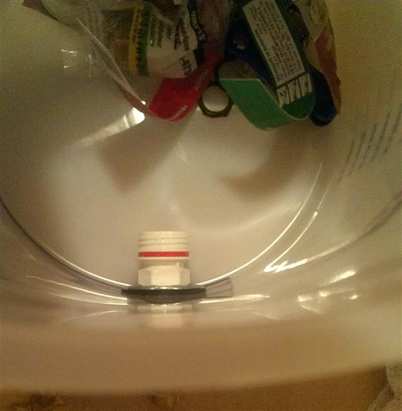

1. Drill 1” hole in bucket at lowest level possible but where sillcock is not below buttom rim of bucket.
2. Take 3/3 x ¾ mip apart and keep the threaded half. On threaded half slide on 1” metal washer (you may have to grind it down on the bottom side to where it fits)
3. I could not find a rubber washer that would fit the 1” needs so the ones I purchased I cut a 1” circle out of the middle and then placed one next to the metal washer on the mip where it would make contact with the bucket..

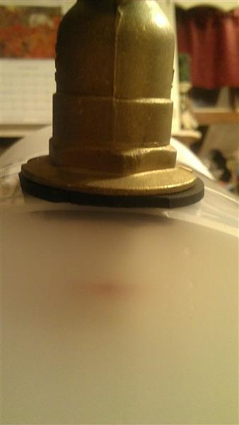

4. Slide threads of mip through inside of bucket with the rubber washer against the inside of the bucket.
5. Place other rubber washer over threads sticking out of bucket

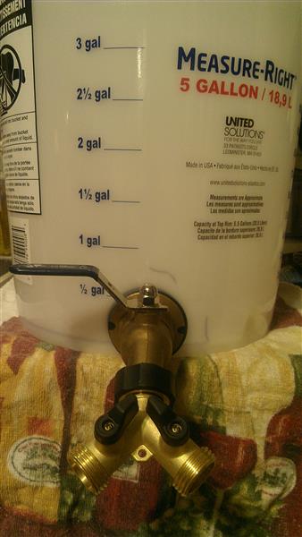

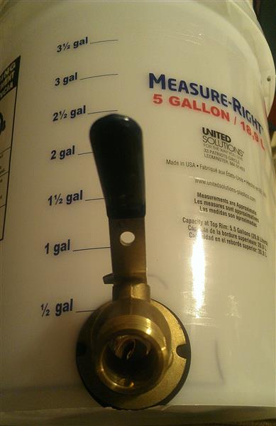

6. Put ¼ turn sillcock onto threads and tighten
7. Attach 2 way onto sillcock
8. Place ¾ x ¾ hose fitting (connects a male to male) to one of the 2 way threads.
(Bucket is done) You can get bulkhead connectors like this http://bucketape.com/bucketapeimages/bulkhead1.jpg from Bucketape.com but I like my setup.

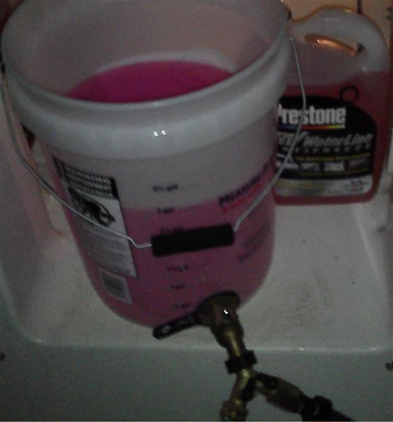

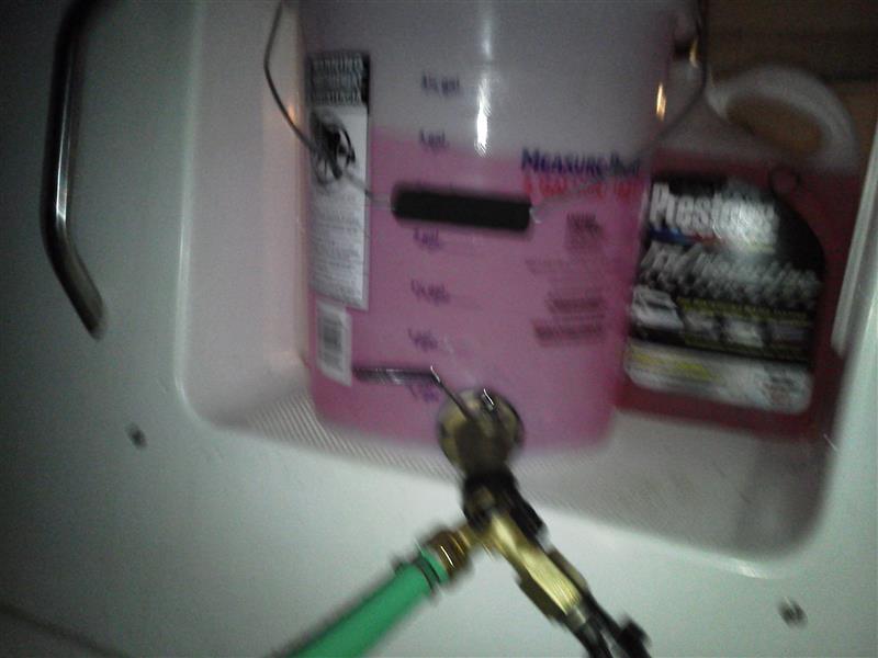

1. To winterize boat connect your normal home/shop garden hose to bucket Y adapter side that has the male adapter and turn off valve for that side
2. Go turn on water
3. Connect Boat hose to muffs and place on drive then connect to other side of Y adapter on bucket

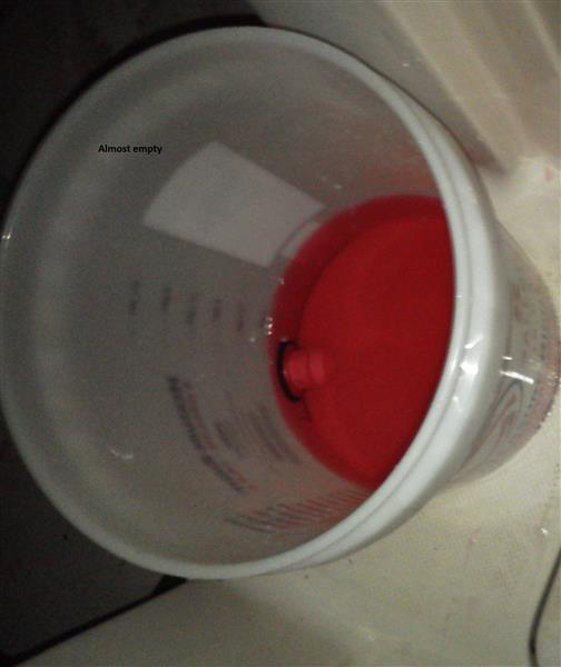

4. Fill bucket with 5 gallons of pink stuff. (I guess you could use less) [the prestone has corrosion inhibitors]
5. Turn on both Y adapter (2 way) valves on where water can go from Garden hose into boat hose
6. Turn on boat and run till at operating temp (you may want to spray some fog into air intake on engine just at or during next step)
7. Once at temp as close to simultaneously as possible turn off garden hose valve and open valve on sillcock
8. If you used the see through bucket now just go the helm and watch antifreeze levels drop in bucket. Once down near the bottom or when you hear it suck air turn off engine. (ENGINE DONE!) Turn off your water and disconnect garden hose)
