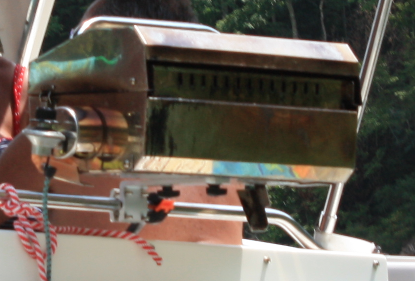

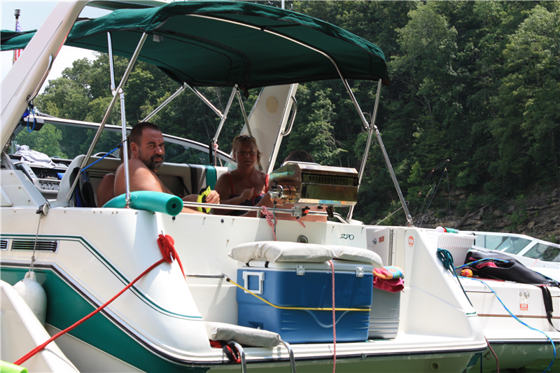

Here's a pic of my rail mount E.
untitled (Custom).png (1.08 MiB) Viewed 8624 times

Thanks! That is like some of the other rail ones I had seen. Does it hold on fine? I just thought they looked like they would flop over. My only experience with a rail mount was my bow pennant holder that always flopped over once I hit about 40 mph. I finally drilled through it and the rail and put a stainless screw in it. lol

It actually holds pretty good, occasionally when I first installed it it would droop a little, when it did I just pulled it up and tighten the screws a little more. Now my rail is slightly egg shaped (better than drilling a hole) and I never have to mess with it. I usually leave the grill on all summer and it never moves. I keep one of those small line levels on board to make sure it is level.
