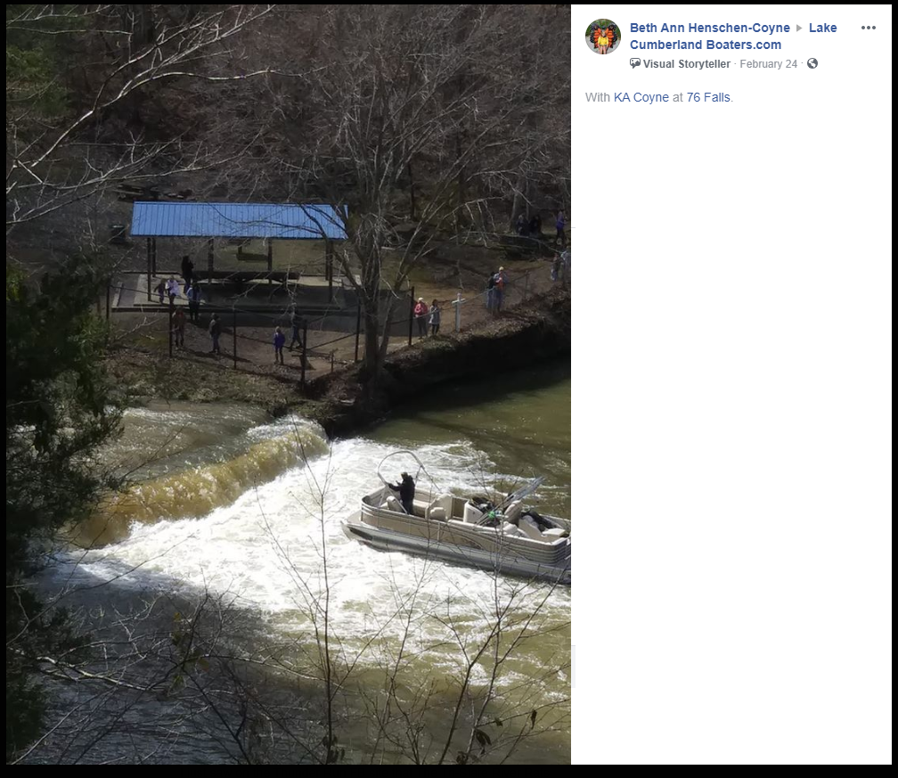

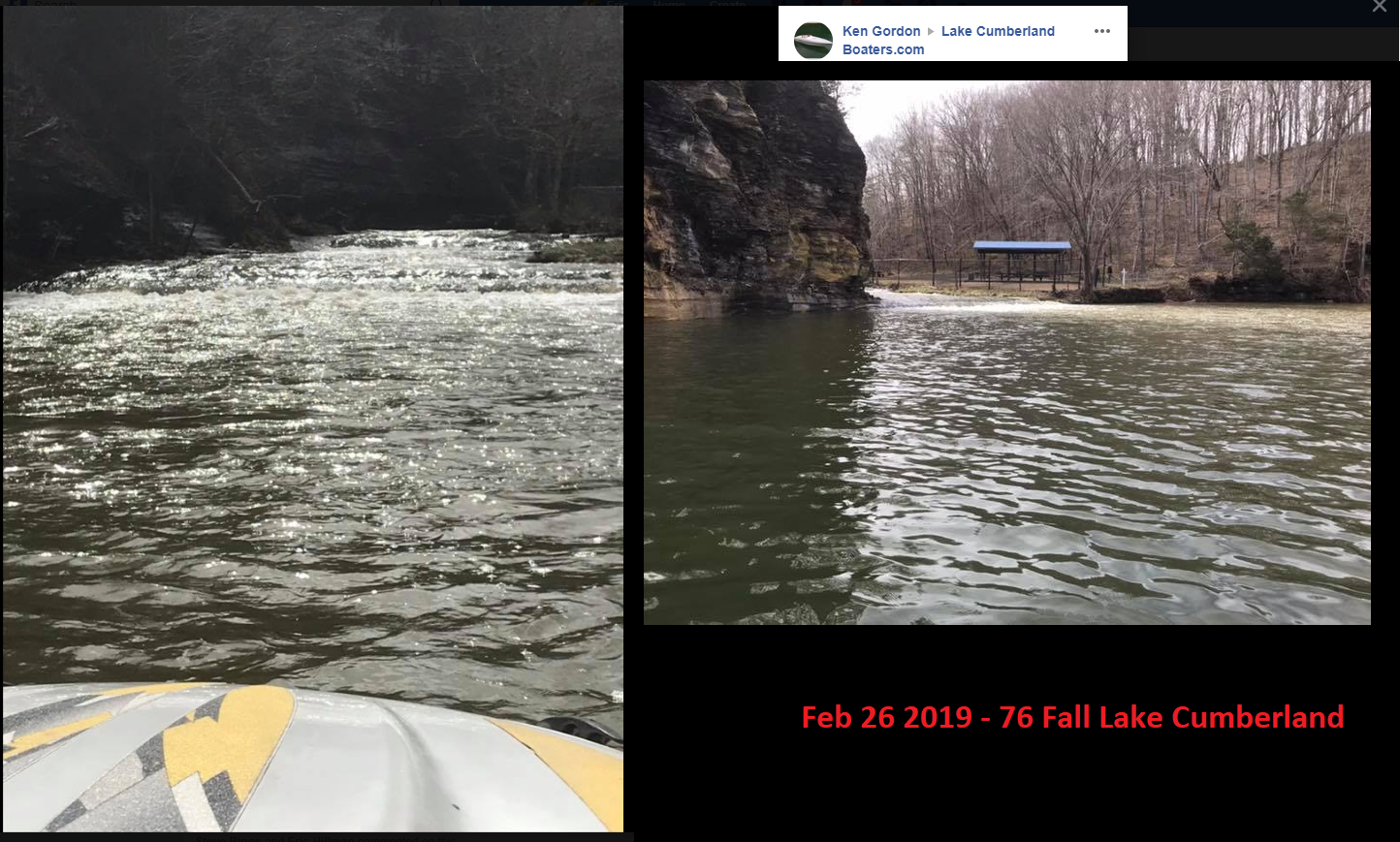

756.52 - 5 am Tuesday Feb. 26th 2019
76 Falls Feb 26th 2019 b.png (1.21 MiB) Viewed 21510 times
76 Falls Feb 24th 2019.png (819.2 KiB) Viewed 21510 times

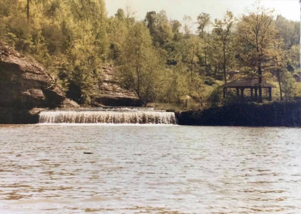

751.70 May 13, 1984 – Recorded at 2 a.m.
76 Fall 1984.jpg (74.56 KiB) Viewed 21996 times

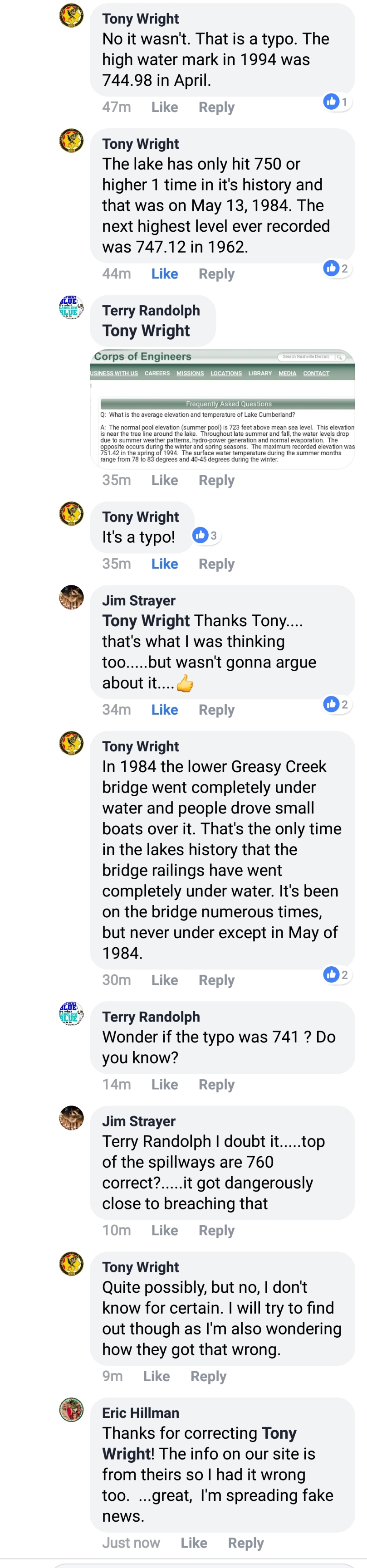

Old 1984 record broken between 8 and 9pm on Feb 23 2019
New Max Elevation updated in 2019 still rising as of 2-25-2019 - 756.07+
